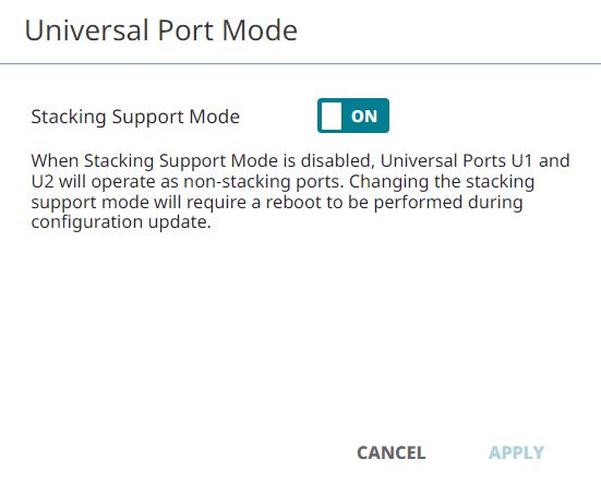

Changing the stacking support mode will require a reboot to be performed during configuration update.
To enable or disable Universal Port Stacking Support Mode:
beside the Universal Ports.
The default value selected for the 4120 SKUs is 1x100G.
Universal Port Stacking Support Mode can also be configured at the device-level, within the Port / VLAN Configuration page. Device level configuration overrides the template configuration.
